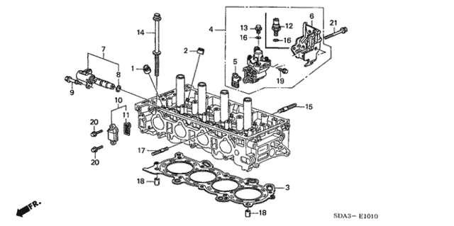

It's some kind of strainer for the VTEC system. And it looks like you have to remove a bunch of stuff to get the lower bolt...(fun).
What looks like the gasket under that plate is called a strainer (#11 in the picture) part # 15845-RAA-A01 for $5 to $10 at a dealer. Mail order on the cheap end of that but shipping probably eats up the savings?

Thanks Jim, for the help! Exactly what I needed. Seems to be a little nasty to get to but I’m going to give it a shot later this week.
