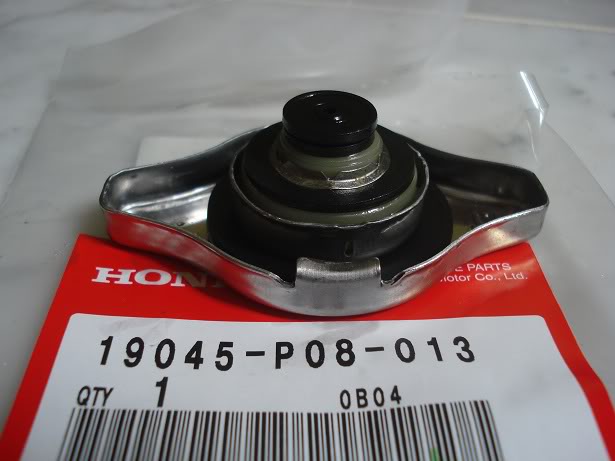

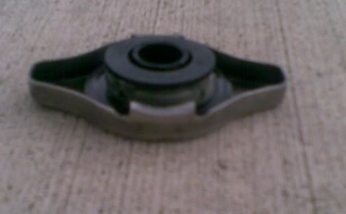

i had the exact same problem a couple weeks ago with my 94. my car was overheating. i would pull over and stop the car, the coolant in the overflow tank was boiling, coolant was leaking at the top of the tank, and the fan was working even tho the car was off.
first i replaced the radiator cap, it was busted btw. u wouldnt know unless u removed the cap and looked at it. was still overheating. it was the THERMOSTAT. replaced it, my overheating was solved. lost coolant while doing it so be sure to have a container worth to refill. and also had to bleed the coolant system of air bubbles. Cost me $32 for the 2 parts at the dealership.
\/ bad radiator cap
\/ good cap
