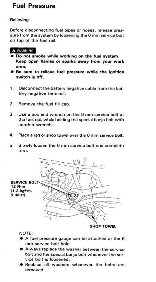

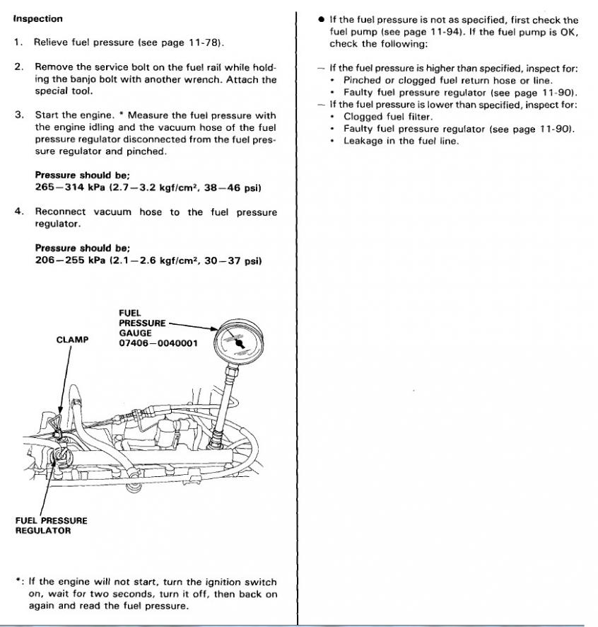

The fuel pressure test procedures for the 1994 Accord are different than the 2002 Accord. See attached pics. for procedures for the 94 Accord 4 cylinder.

We checked the fuel pressure from the fuel pump and it shot out strong on trying to crank so its getting fuel for sure.
