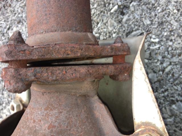

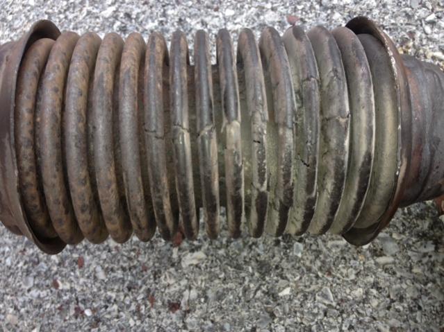

After investigation, found that the flex pipe bellows had cracked and leaking exhaust (see pic, hard to see but where the cracks are there where little cracks underneath).
Replaced flex pipe (section from manifold to cat), new bolts (also had to replace the "out" side of the cat's bolts <see pic> two nuts had literally disintegrated and there was a huge gap) , new gaskets. Cleared code. Tested and NO leaks present from the manifold back. Drove it for about 50 miles and CEL back again.
