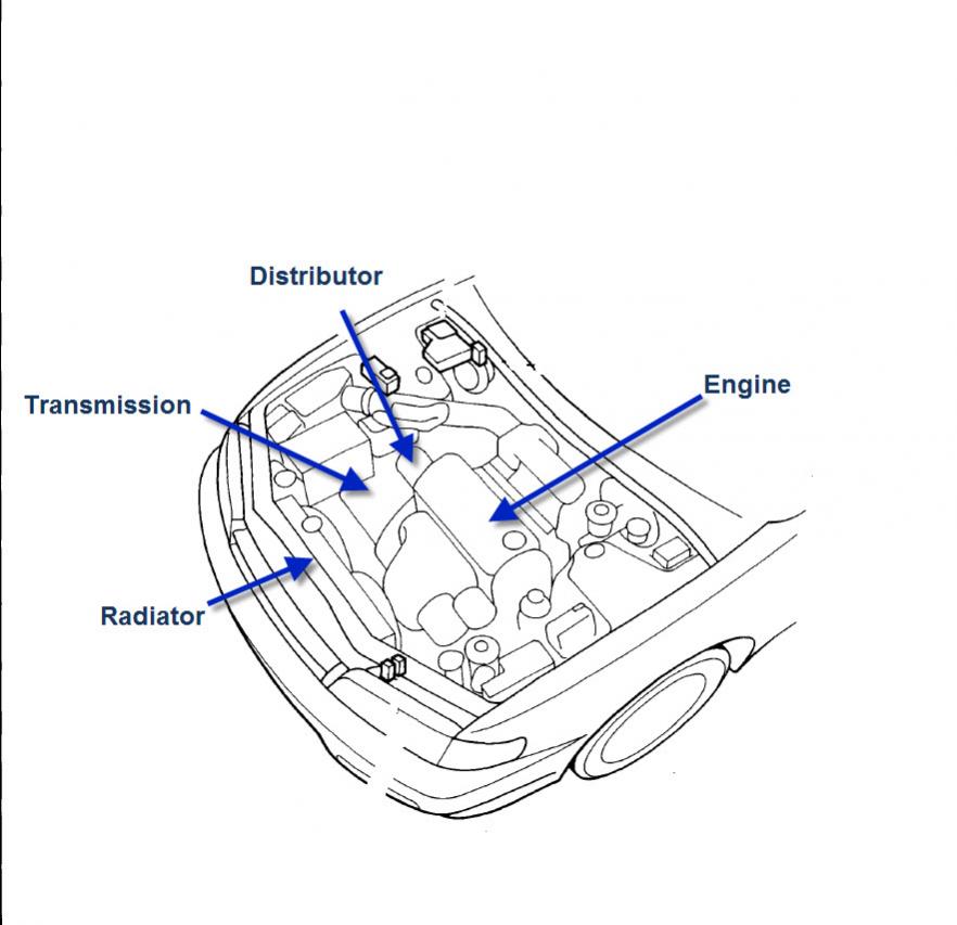

Under the hood, is the leak near the front (near the radiator), the middle (near the transmission area), or the rear (next to the firewall)?
Look under the distributor area (see attached pic.), see anything? There is a heater hose that attaches to the engine under the area of the distributor.

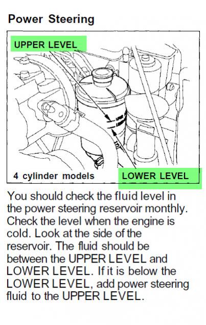

How does the power steering reservoir fluid level look? You can check this anytime, it should be between the upper and lower lines (see attached pic.).

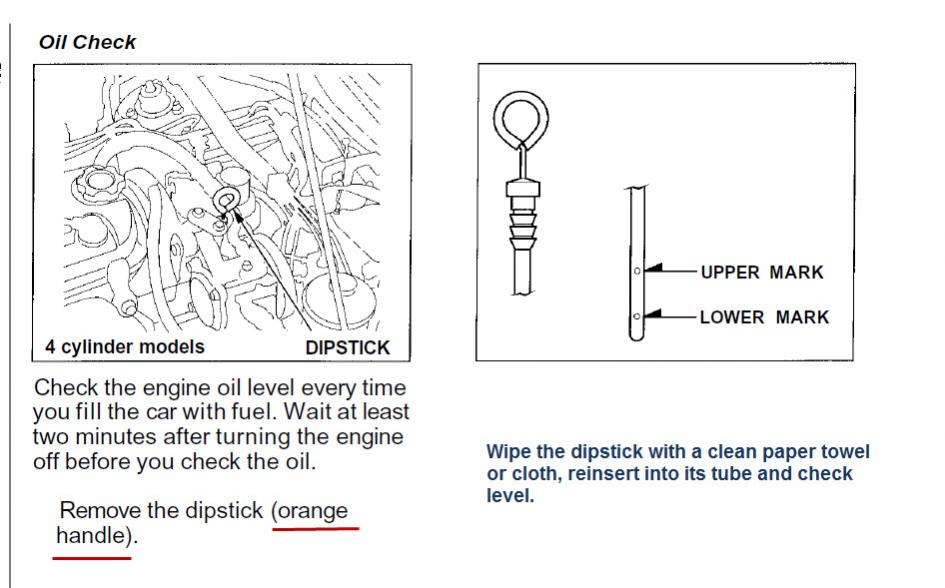

Also check the transmission fluid (yellow handle) and engine oil (orange handle).

Q: Under the hood, is the leak near the front (near the radiator), the middle (near the transmission area), or the rear (next to the firewall)?
A: I can't tell where it is coming from when you look under the hood but the spot under the car is in the front on the passenger side.
Q. Look under the distributor area (see attached pic.), see anything? There is a heater hose that attaches to the engine under the area of the distributor.
A: I will do this tomorrow

Q: How does the power steering reservoir fluid level look? You can check this anytime, it should be between the upper and lower lines (see attached pic.).
A: I will check this tomorrow as well I was gonna check the other day but I didn't know where it was.
Q: Also check the transmission fluid (yellow handle) and engine oil (orange handle).
A: Checked both and levels were both good.
