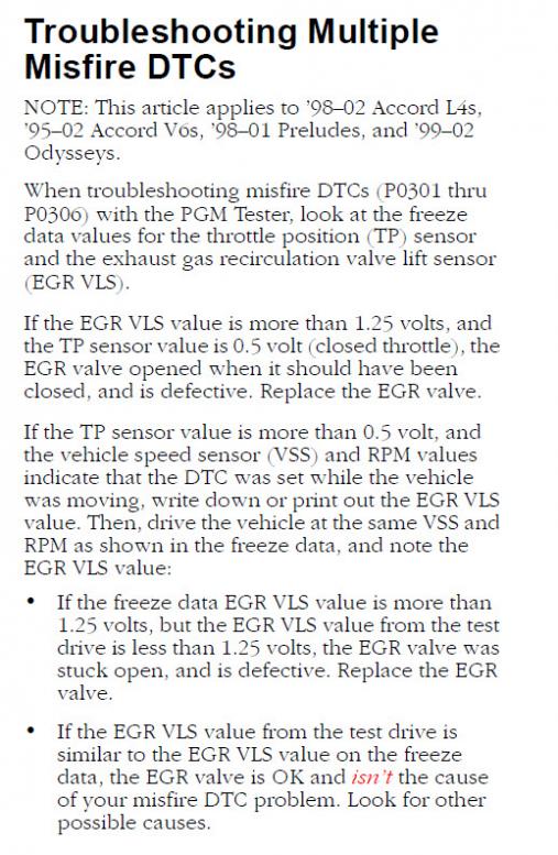

The attached image has some info. regarding a faulty EGR valve which can cause the multiple misfires. However, it may not be the EGR valve though.
Attached Thumbnails Please help - my family is struggling without the car-multiple-misfire-dtcs.jpg
