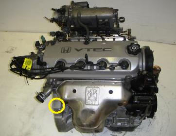

Yellow circle in the attached pic is where the engine number is stamped (or maybe engraved). It is right on the block, no metal plate.

PAhonda - Believe it or not, I don't see any spot like the one shown in the image. Is it possible it's behind the header's heat shield? I search around for a good ten minutes, and all I found was that sticker right next to the starter!?

Found it!!!!! Engine #: F22B1
