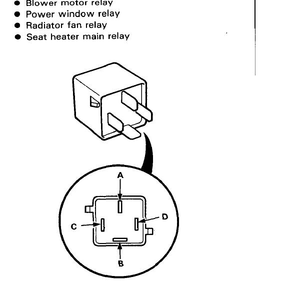

Test the relay(s) and input. I hope this pic will help - sorry the manual I have for the 4th gen....sucks.
Pull the relay - check for continuity between "C" and "D" pins on the relay....is it there?
Apply power and ground to the same pins. Power to "C" and ground to "D" - check for continuity between "A" and "B"? Is it there?
Translate where pins "C" and "D" plug into the fuse box. With the key on - check those for power or ground. One should have power, one should have continuity to ground.

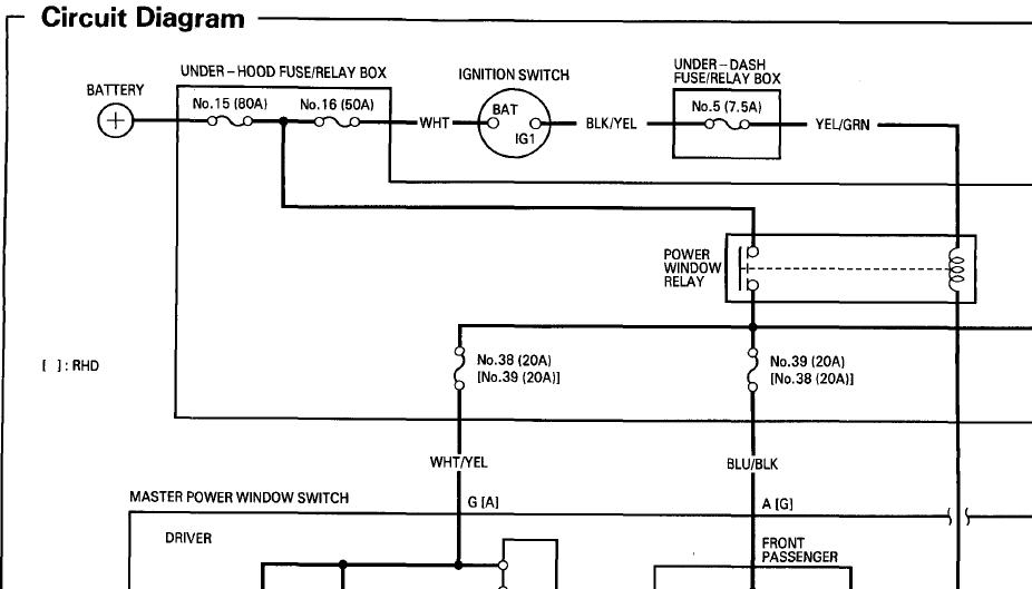

1. Remove power window relay, turn ignition ON. With black lead from voltmeter touching chassis/body metal ground, use red lead from voltmeter to check voltage where the window relay was located in the under-hood fuse/relay box. (You are checking whether power is coming through the Yellow/Grn wire from the Integrated Control Unit (ICU) to where the relay is.)
Alternative to check whether power is coming from Integrated Control Unit (Located in the under-dash fuse/relay box). At the ICU, with a backprobe at the Yellow/Grn wire at the 16-P Green connector (C403 connector), turn ignition ON. Touch black lead to chassis ground, and red lead to backprobe at Yellow/Grn wire, is there voltage?
Backprobing is either using a backprobe set or using a thin needle or something and making contact with the metal terminal of the connector without piercing the wire in the back of the still connected connector. Be very careful not to damage the wiring.
2. If there is power coming in to where the relay is, then test the relay (or you can always test the relay before).

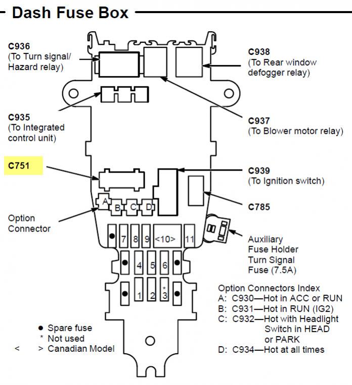

2. Check that the 18-P Grey connector (C751 connector is located in the front of fuse box) and the 12-P Brown connector (C502 connector is located in the back of the fuse box) are firmly plugged into the under-dash fuse box. – If they were loose, this may take care of a few problems.
