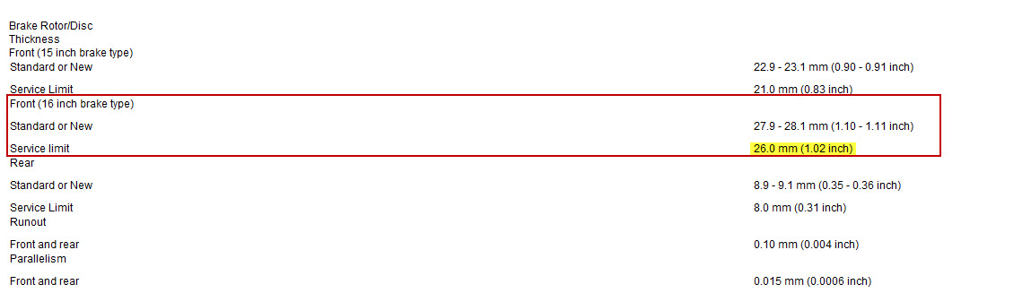

i just bought an 04 accord ex coupe. 6 cyl and 6 speed.
im looking for rotors and i dont know what size to get. apparently there is an 11.1 inch and an 11.8 inch front rotor. i dont have an owners manual im thinking that since it is a six speed that it is probably th 11.8 inch rotor
any help would be greatly appreciated

Take off your wheel and measure the rotors you have on the car...
Old Jan 15, 2011 | 11:33 PM

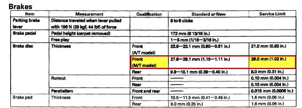

For the V6, Manual Transmission, Honda calls them 16 inch brake type and yes, the rotors size is smaller than that. I believe the 16 inch brake type is the 11.8 inch front rotor. But, like WheelBrokerAng stated, you could have taken off the wheel and measured the rotor.
