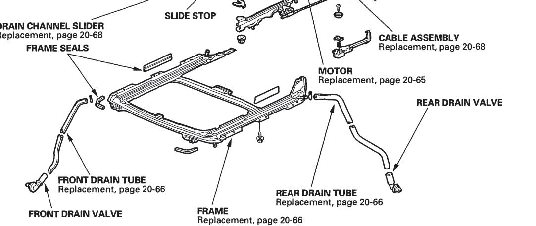

Old Mar 29, 2015 | 05:44 AM
I'm still with the moonroof drain tube. What happens is the tube slips out of the drain valve.

Found it, the sun roof drain tub came off.
But when I go to put in on it just taps the black rubber 90 degree bend. Its like to short by like a 1" I would say? I pulled on it and stuff and got no more length out of it? Is there a fix for this?

Glad you found it. You can put some compressed air through the drain lines, flush them with some water to see if the drain correctly and reconnect. If you need to retro fix it the hose barbs and proper diameter tubing will work fine. You can also take off the plastic cover that runs from the top of the door frame down to the top of the dashboard. Under that cover you should find the drain hose.
Old Apr 7, 2015 | 06:08 PM
Not a fun job.....had this issue on 2 different 3rd gen's.
Before trying to replace the tube - not a fun job. Try getting some pliers in there and a good pull on the tube and see if you can get the added length. If so, what I did with mine was add some silicone sealant to the tube - not at the very end but back ~1/2 inch where the drain tube would just meet the end of the drain valve tube. You might have to remove/loosen the fuse panel to get a good grip on the tube.
