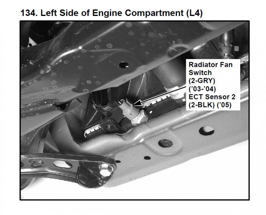

The radiator-fan switch is located in the lower tank of the radiator. I think it's the only thing down there with a wiring plug. Unplug that & jumper the wires with a paperclip or short piece of wire.
Key on, that should make both fans run. If that's OK, then there's 2 things to think about...

Ya, I was looking at the switch yesterday and one of the 2 wires leading into the plug was completely broken and the other was frayed. When I touched the 2 wires together the fans came on.

The 2P radiator fan gray connector doesn't have what Honda calls a secondary lock (e.g, depending on connector style; plastic piece to pull out, flip up/down, etc.).
Honda doesn't show terminal replacement instructions for that type of connector for the radiator fan switch. But, most pins can still be released with a pin tool and pushed or pulled out the back.
In regards to the Honda harness, it is part of the front engine harness, and retails for approximately +/- $110, pricing varies depending on trim level. It is approximately +/- $80 plus shipping at online dealer. Less if used.
