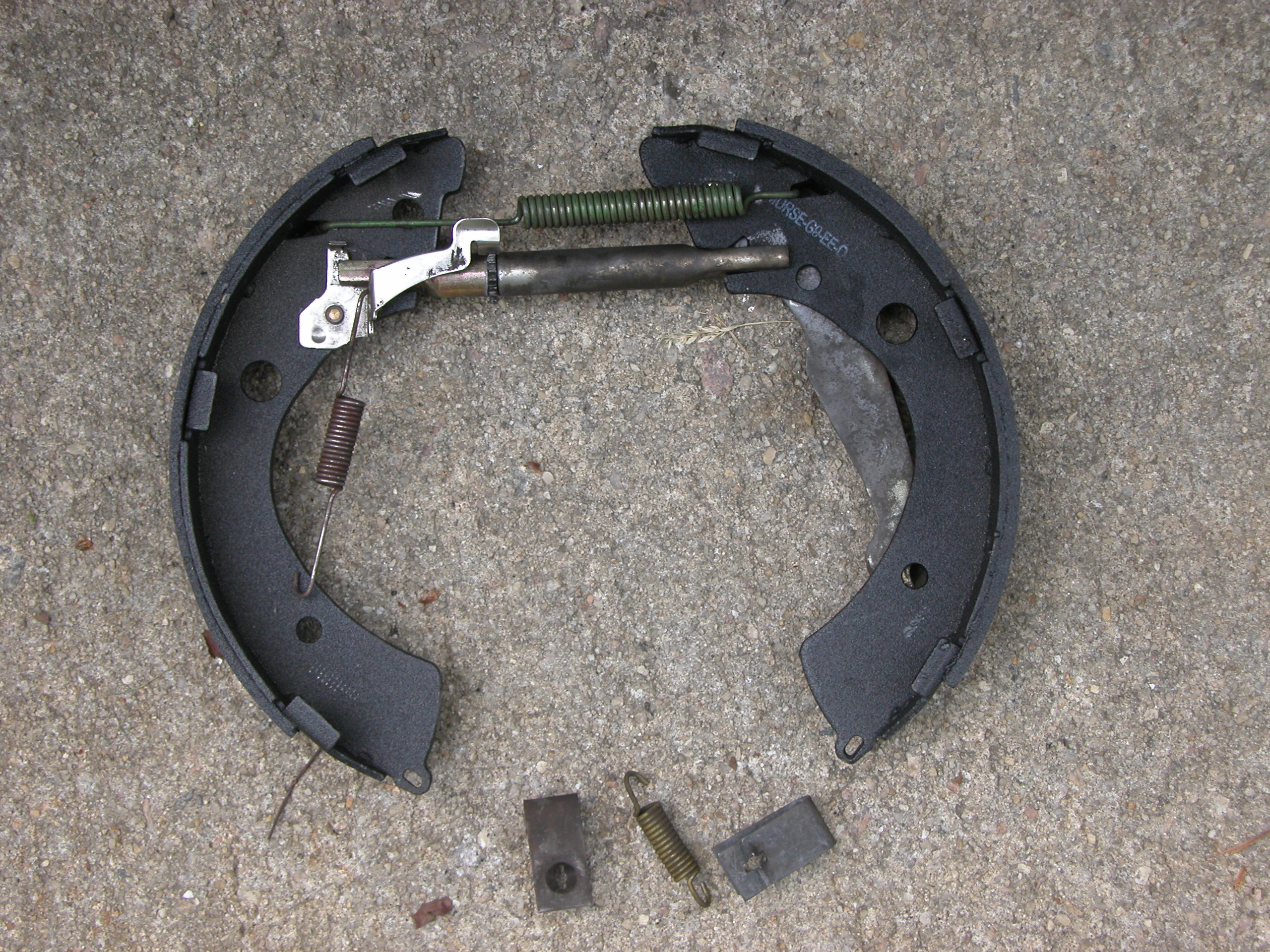

One day I'll have to make a write up on how I do this. I was taught a "trick" by a friend who owned a shop with his brother years ago.
Remove the shoes with the upper part all connected!
You can remove the lower spring, the pins that hold the shoes to the backing plate. Compress the wheel cyl slightly, you can push the top of both shoes or use pliers - don't damage the rubber boots. Optional, you can open the bleeder to keep the cyl from wanting to "open" back up.
Slip the bottom of the shoes from behind that lower "plate". Then push the bottom of both shoes together, this spreads the top apart enough to clear the wheel cyl.
You can then get behind the one to the e-brake cable and remove it.
Bam, shoes are off and can be laid on the ground and transfer the neded springs from the old shoes to the new ones......or give you and idea of how the new springs and hardware go on the new shoes.
In the pic you can see how I had the new shoes set up with springs attached while sitting on the ground. I picked up the "assembly" as seen and installed them using the reverse of removal.
Done
