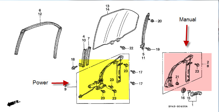

If you try modifying, you may be restricted by the travel of the window regulators. The rear regulator are somewhat shorter in length compared to the fronts.
Even the newest Accord sedan rear windows do not go all the way down.
Attached Thumbnails Rear Door Windows..Can I get them to go lower?-window-regulator.jpg

Note the dogleg on the bottom of the back doors to accommodate the rear wheel wells.
