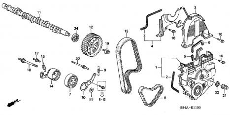

You'll need to loosen the valve cover because it captures the upper edge of the upper timing cover. Don't have to REMOVE the valve cover, just lift it a few mm.
Then there's only a couple screws for the plastic upper timing cover.
Now you might not be able to see the leak because the balance shafts are down lower, well into the lower timing cover. In the picture, you can see a couple round things molded into the lower cover. That's where the balance shafts are located.
Maybe it's the camshaft seal that's leaking?? Then it would be easily visible.
