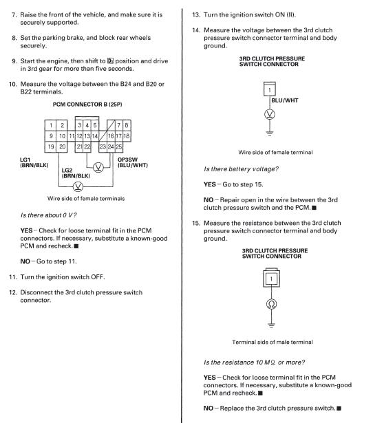

I found this to test it
1999 Accord: cyl..3rd clutch pressure switch circuit..diagnostic..cars - JustAnswer

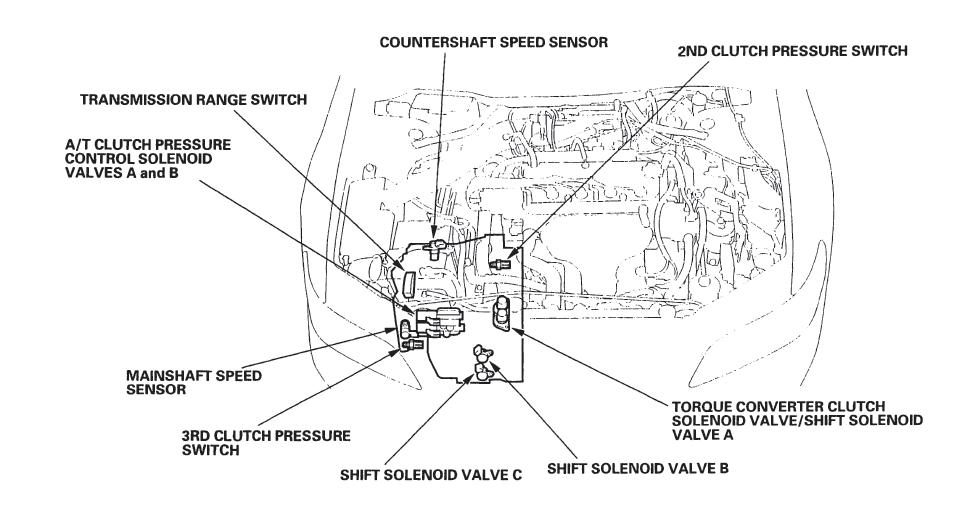

I checked the 3rd clutch pressure switch. I'm getting 5 volts at the sensor (unplugged), do I need to see 12 volts?
I also checked the ohms on the switch itself and I'm seeing o ohms. Part 14 is what i'm gathering is the 3rd clutch pressure switch
<a href="http://smg.photobucket.com/albums/v6...01_atm0710.png" target="_blank"><img src="http://img.photobucket.com/albums/v6...01_atm0710.png" border="0" alt="Photobucket"></a>

That pic looks like the switch.
Also check the settings on your volt meter - you should have battery voltage (12v) on the wire?

I'm concerned that you do not have battery voltage to the switch.
The pic I posted is like step 5 of some number but it does say that if you do not have battery voltage at that wire to check the "wire" from the PCM to the switch....one of the earlier steps was to check the pin at the PCM.

I checked the pcm connector according to the diagram you posted. I'm not seeing any voltage, so thats good
I checked the switch again and I'm definatly getting 5-volts not 12.
And I'm seeing 0-mohm's on the switch itself, so it appears the switch is ok, but my voltage is weak.
I just checked the voltage of the blue/white wire leaving the pcm ( pin 24 on the pcm "b" connector) I'm assuming it's the same blue/white going to the switch....I'm seeing 5- volts
So it's not the wire going from the pcm to the switch, it appears to be the pcm. What do you think?
