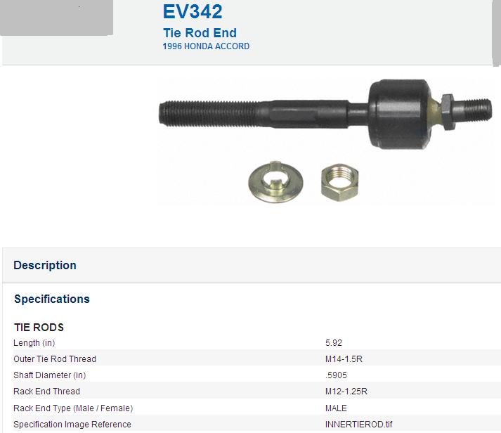

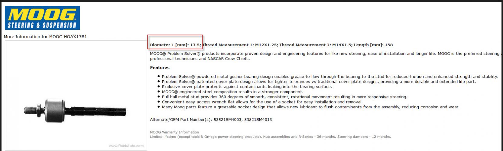

Strange......I can't seem to get my hands on the spec's for both??????
Attached Thumbnails Replacing Tie Rod Dust Seal Boots-5th-gen-inner-tie-rod-spec.jpg

Thanks PM, I have been driving the car and so far so good, but again last time inner tie rod came loose after nearly 8 months
I am NOT sure about 'Diameter' since it's different for 1996 and 1992 accords, but all thread size look the same.
Please see attached pict for 1992 accord, pict you posted and this one has same thread size. What you say and advice?
