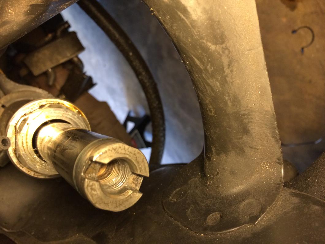

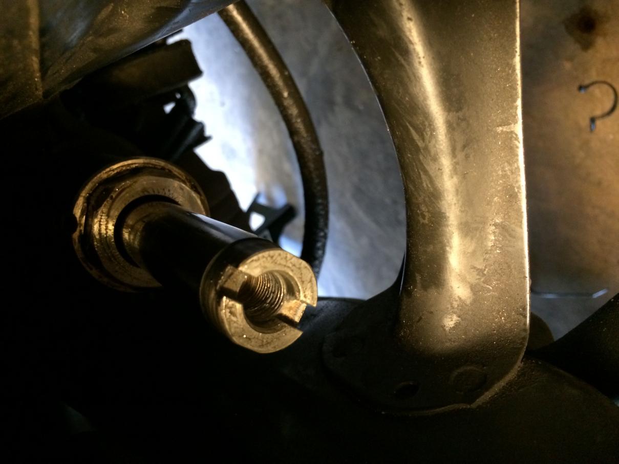

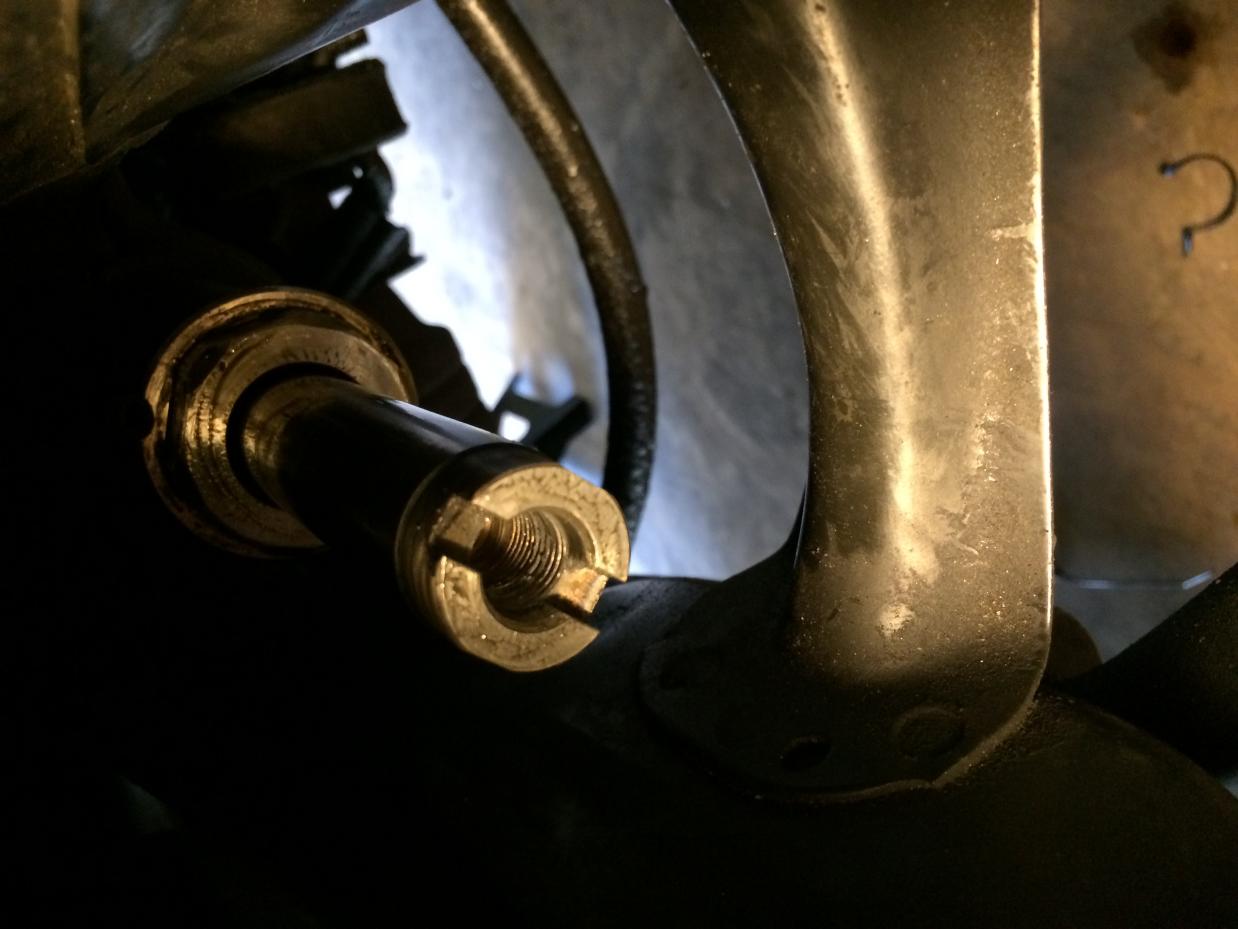

Here is another problem, I looked at the threads more carefully today. Threads in the front look more stripped than the back ones, back ones look just fine.
Please see attached few more picture, not sure if anything is going to fix/work on em?

The threads look usable. There are many companies that sell the kit I posted under different names and prices including Craftsman and you don't need the whole kit. I question if the tie rods are machined for the threads in your rack judging by the thread damage on the tie rod ends.

Tap or thread chaser will work. Blow out chips w/ air after cleaning.

Guys, I tried to repair the the threads and it's definitely beyond repair and I feel, it's pretty dangerous to fix it like this
I am gonna go to a JY tomorrow and pick up the used rack/pinion. If I couldn't find any, gonna buy a re-manufactured one and will keep you guys posted

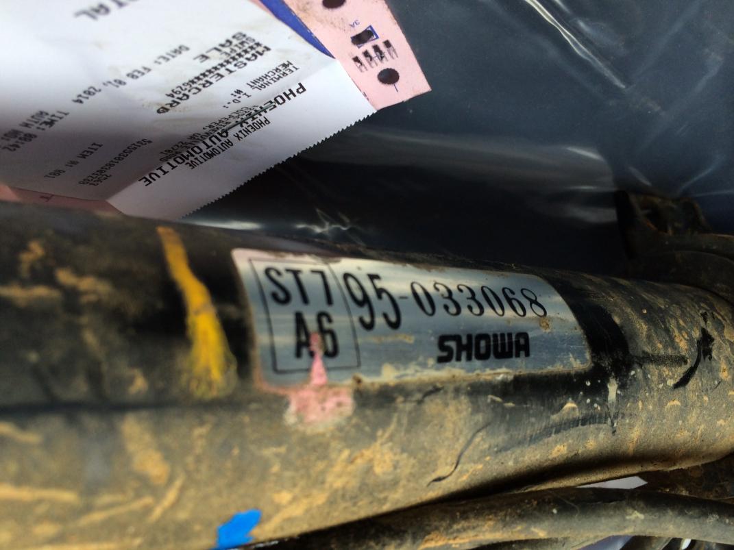

Hi Guys-
So, I got this part today, it's NOT a Genuine OEM part, rather a re-manufactured one.
Boots, all lines and tie-rods arr in pretty good condition, but my question is, is this a right part?
Please see attached image with part Number/Info.
Would really appreciate if any of you can confirm about the part.

Can't really tell by the sticker? That is the "maker" of the racks for the accords ("showa")
