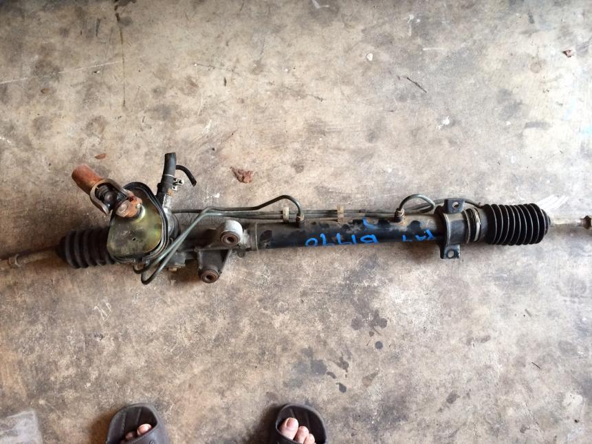

I am going to post more pict and dimensions of the rack, looking for your help and input to make sure if it's the right part.

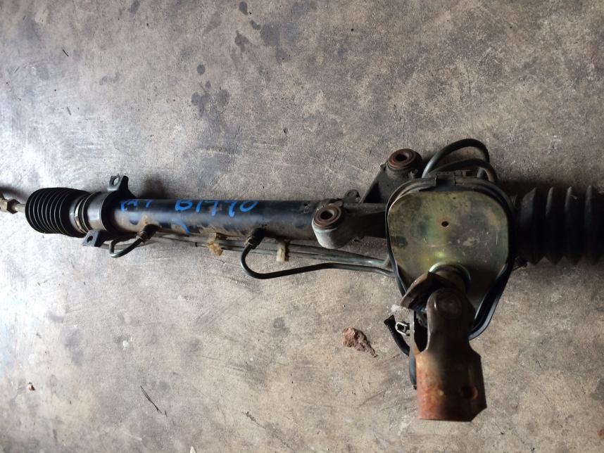

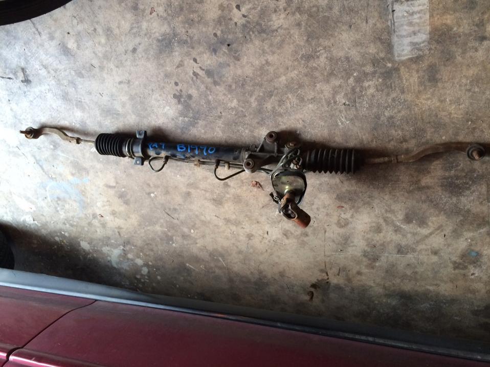

Yes, according to them it's the right part, let me take a pict and share the ticket information with you as well
Please see attached pict and dimensions below for more information.
Diameter of Black center pipe = 5.75"
Outer Tie rod to other rod = 54"
Bottom to Top of Shaft =9"
Diameter of Shaft=3"
"Nut'' between Outer/Inner Tie-Rod to other=39"
Between two small pipes= 7"
Between One Bracket to other= 18"
Length of Bracket close to shaft=5.5"
Inner side Bellow boot(close to shaft) from one end to other(close to bracket) = 22"
