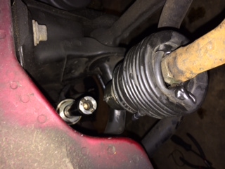

I did my both inner and out tie-rods nearly 5-6 months ago.
NOT sure how and why , inner tie rod has come loose from steering rack and pinion, from the joint mentioned in the attached pict.
What's the easiest way to put back inner tie rod into the steering rack? Since outer tie rod is still intact, anyway I can avoid alignment expense since I had alignment done 5-6 months ago. Also, if stopper washer is missing, where can I buy stopper washer?
Old Dec 31, 2013 | 08:28 AM
  #37
Two ways for the inner tie rod to separate; tie rod not inserted into slot and/or lock washer improperly set. I guess structural failure of tie-rod is another possibility.
The ball jt would allow inner tie-rod end to be rejoined to steering rack w/o changing the outer tie-rod position. However the dust boots may be in the way and may require removal for access.

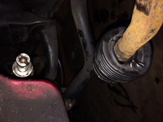

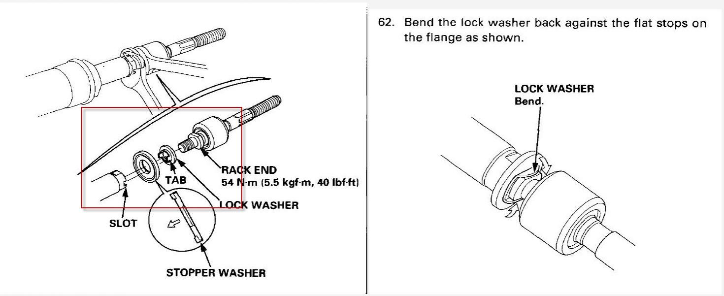

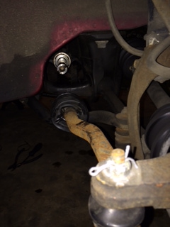

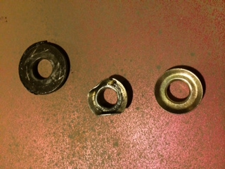

Thanks so much 'TexasHonda'.
Please see attached few pictures.
What's the best way of tightening the inner tie rod into steering rack? Without opening outer tie rod, so that I can save on alignment.
Also, I am bit confused about the direction of 'Stopper Washer' it can go either direction or there is any specific direction?
What's the best way to bend the crush/lock washer, why it has come loose at the first place?
Please see attached few picts and waiting for your response and reply.
Attached Thumbnails Replacing Tie Rod Dust Seal Boots-photo-1.jpg   Replacing Tie Rod Dust Seal Boots-photo-2.jpg   Replacing Tie Rod Dust Seal Boots-photo-3.jpg   Replacing Tie Rod Dust Seal Boots-photo-5.jpg
Old Jan 1, 2014 | 10:25 AM
  #39
A special tool is used to reach the nut. It should be available for rental from Autozone, or other parts houses.
The lock washer bends back over the nut to prevent nut from rotating after tightening.
I found details under Power Steering in download shop manual.
