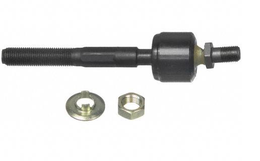

Yea, the lock washer in your pic's doesn't look right?

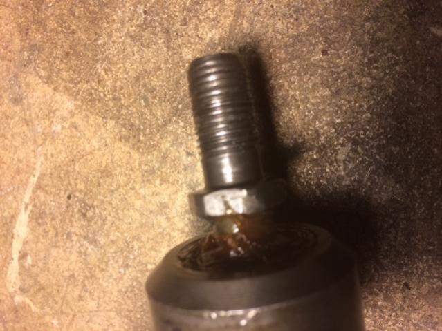

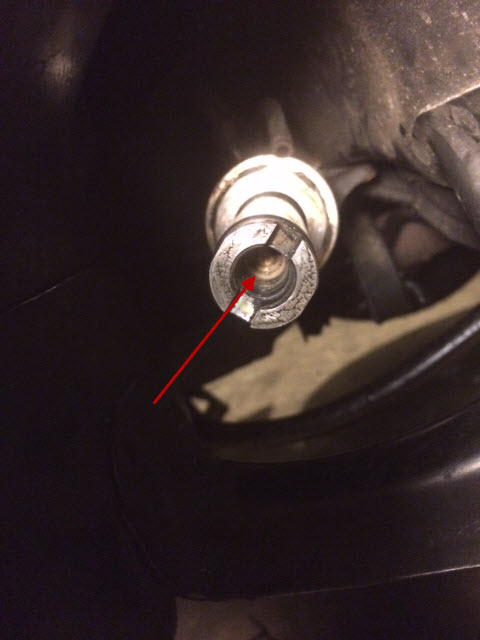

Actually washer was exactly same as you have posted, but since I bent it, no longer look a new one.
Now I am in a BIG dilemma(I think), seems like threads inside Rack/Pinion and inner tie rod are slipping/worn out. I am NOT able to completely tighten inner tie rod into rack and Pinion. It goes in, but does not GO all the way down into it. I can see that threads are NOT even inside Rack/Pinion.
I mean, if inner tie rod threads are bad, I can just get another one, but can't do that with Rack/Pinion.
Please see attached pictures.
How can I overcome and fix this problem? Please help

If the threads are bad on the rack.....
You could try to "chase" the threads to fix them. There may be some thread repair kits (heli-coil) that you could try......last, the rack will have to be replaced.

Chasing threads is using a tap to "correct" damaged threads and enable re-engagement of tie-rod. This will work if damage is light.
Someone may have crossthreaded or inserted SAE tie-rod into metric rack/pinion.
Based on male end appearance, I would not be optimistic.
The helicoil fix should be possible, but will be difficult in tight space. I would suggest searching for a shop w/ some experience in installing helicoils to perform this work.
