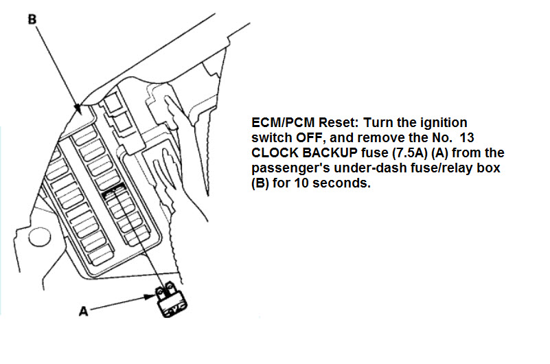

Posts: 7,101
ECM/PCM reset only requires the back-up fuse pulled for 10 seconds. There is no need to disconnect the battery for 30 minutes.
https://www.hondaaccordforum.com/for...-ecm-reset-jpg
