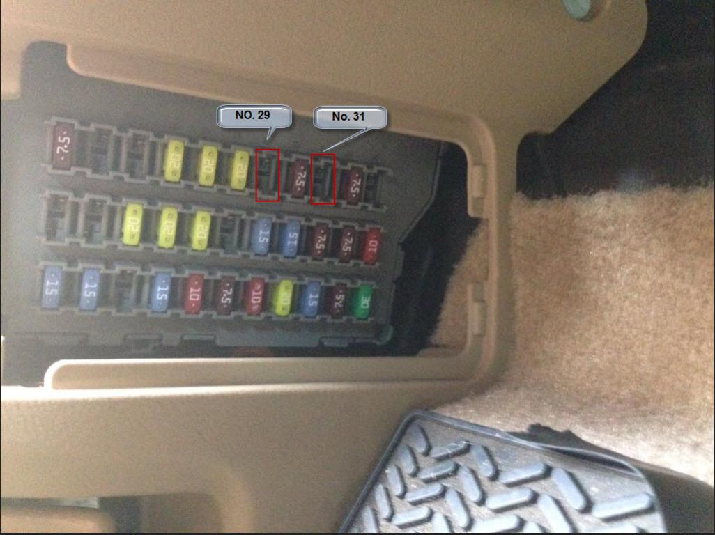

The fuse box lid should say the numbers. I previously listed the unused slots for all models. On your car, you have even more due to the trim level not being fully equipped as some of model trim levels.
See attached picture. These should have power with the ignition in ON or START.

The receiver and transmitter work fine however, I tried using the two open ports (29/31) and that did not power the monitor on. I then tried using port 7 which is the back up port and that failed as well. Unsure why or what to do from here.

Try a used fuse slot to piggy-back off of. Read the littelfuse instructions regarding how to piggyback a used fuse slot.
