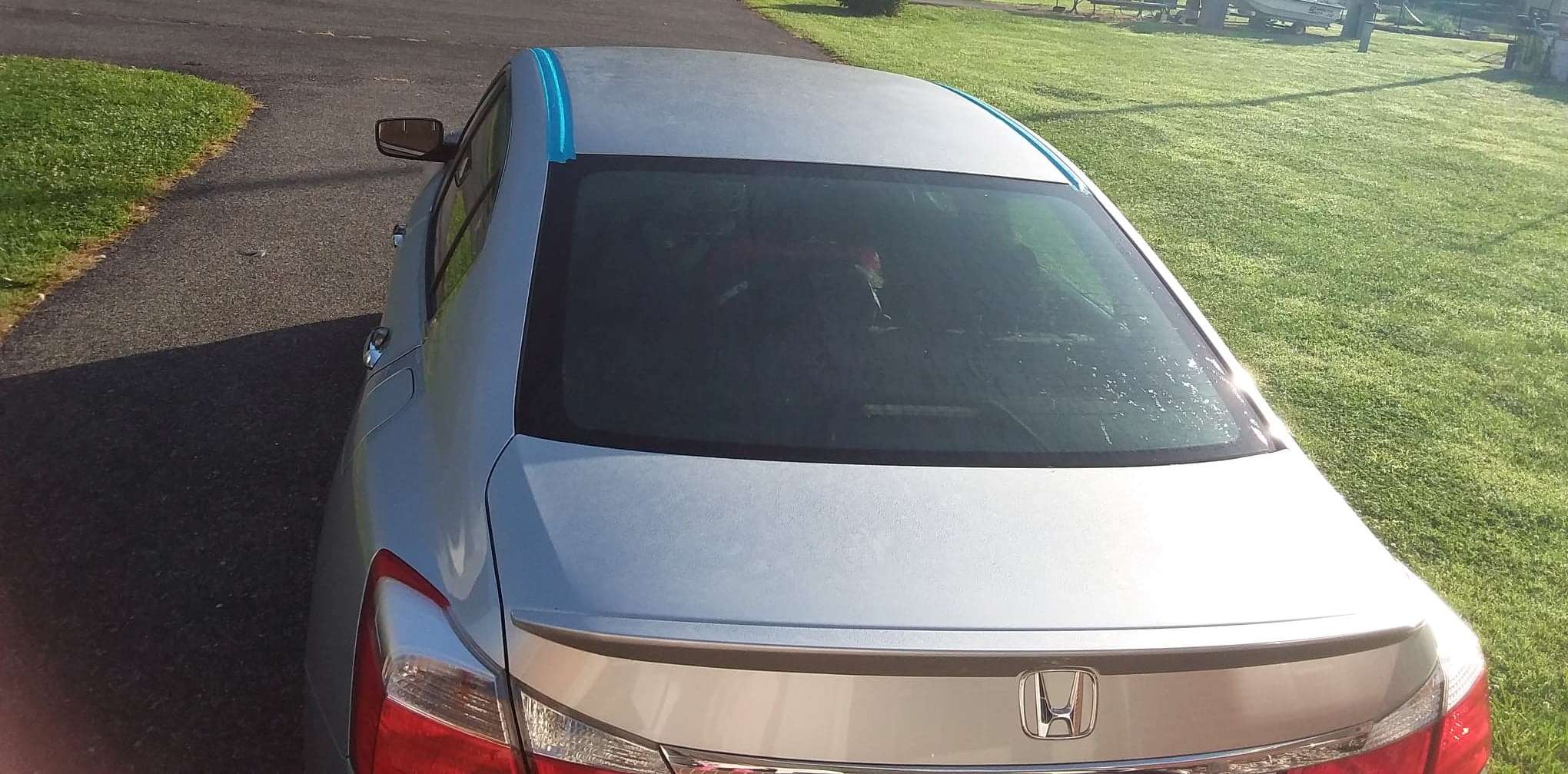

took the car to auto body shop. where they taped up the roof moulding channels, car still leaked. discovered it is the back glass leaking. anyone else have this problem? It's gotta be a manufacturer's defect.

I don't recall many posts on this site where the rear glass leaking on any year accord.
You will have to inspect that rubber seal around the window and the rubber adhesive they use to seal the glass to the metal window frame.

the back window has been taken out, resealed the two top corners where it leaked. leak is now repaired by local body shop. manufacturer's defect, no doubt.
