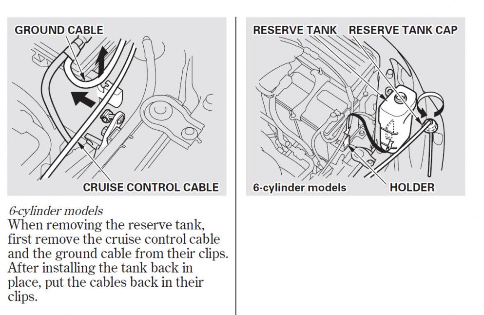

Hey guys,
I am rebuilding our wrecked 2001 accord ex, v6, 2d.
I had to replace the radiator support, but I cannot figure out where the bracket is to mount the burp tank. I have a new tank, I cannot find a bracket on the old, and I cant order one anywhere.. does anyone have a picture of how the stock tank mounts?
it looks like it should snap in.
Thank a lot
-John

See attached pics.

thanks, looks like it clips into the battery tray... that would explain it. thanks again.
