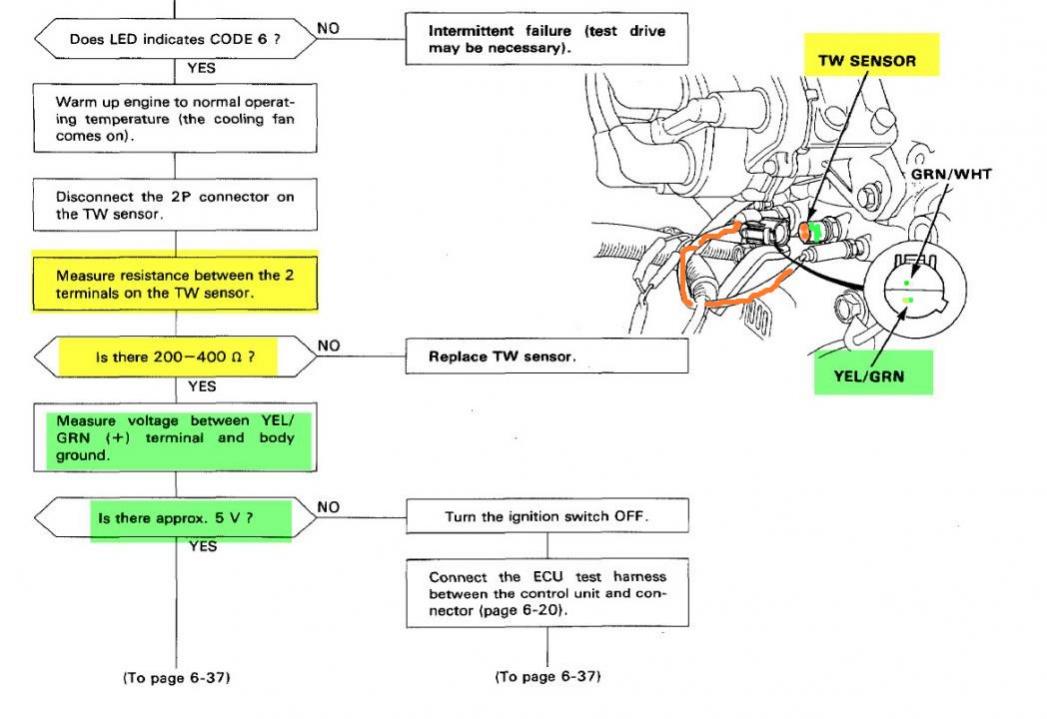

An image from another post [ attached ] shows the location of the TW sensor, the one implicated in this error code.
-- What is the device to it's right from which the wires exit? it too looks like a sensor. Am I mistaken?
I have taken off the connectors, and sprayed contact cleaner on them. It seems to have helped. I find it difficult to get a meter into the sensor location to test the resistance, but if the problem re-occurs, I guess I'll have to remove it? to test it, and +/- replace it.

The part is the sender for the temp. gauge.
Old Jun 27, 2012 | 10:15 AM
That picture of the wires seems misleading. The wire doesn't go from one sensor to the other. Each sensor has it's own wire going into the wire harness.
The TW sensor is shown unplugged. That measures water temperature for the engine-control computer.
Just to the right is another sensor with only 1 wire. That's the sender for the dashboard temperature gauge.
Now for the D4 lamp blinking... When you jumper the SCS connector, the D4 lamp is flashing it's own error code. Count the blinks the same way but you look that code up in a different list (transmission errors). It might be a completely unrelated problem.
