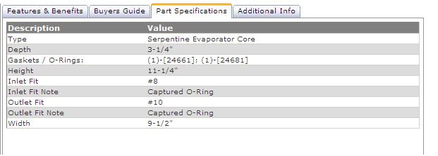

I'm using the Heater & AC box that fits under the dash of a '94-'97 Honda Accord in a 1937 Buick Roadmaster.
The HVAC fits perfectly under the dash.
The engine I'm using is an (LT1 V8) and AC compressor are all from a 1995 Buick Roadmaster.
I need to have custom AC lines that connect from the a) GM compressor to the Accord Evaporator and b) from the Accord evaporator to the GM drier receiver.
What I'm looking for is the thread specifications that are on the 94-97 evaporator at the firewall.
Thanks

Not sure if this helps but all I've been able to find so far. You can check four seasons (4 Seasons - Home) for more details. As far as I can tell, to date, the threads are standard threads and you just need to get the correct hose size......hope this is of some helps.......54187 is their part number for the evap.
Attached Thumbnails Specification of AC evaporator connection?-evap-specs-54187.jpg

Thanks for your help. I'll bring it into a place that does hoses and they'll probably be able to help me out.
