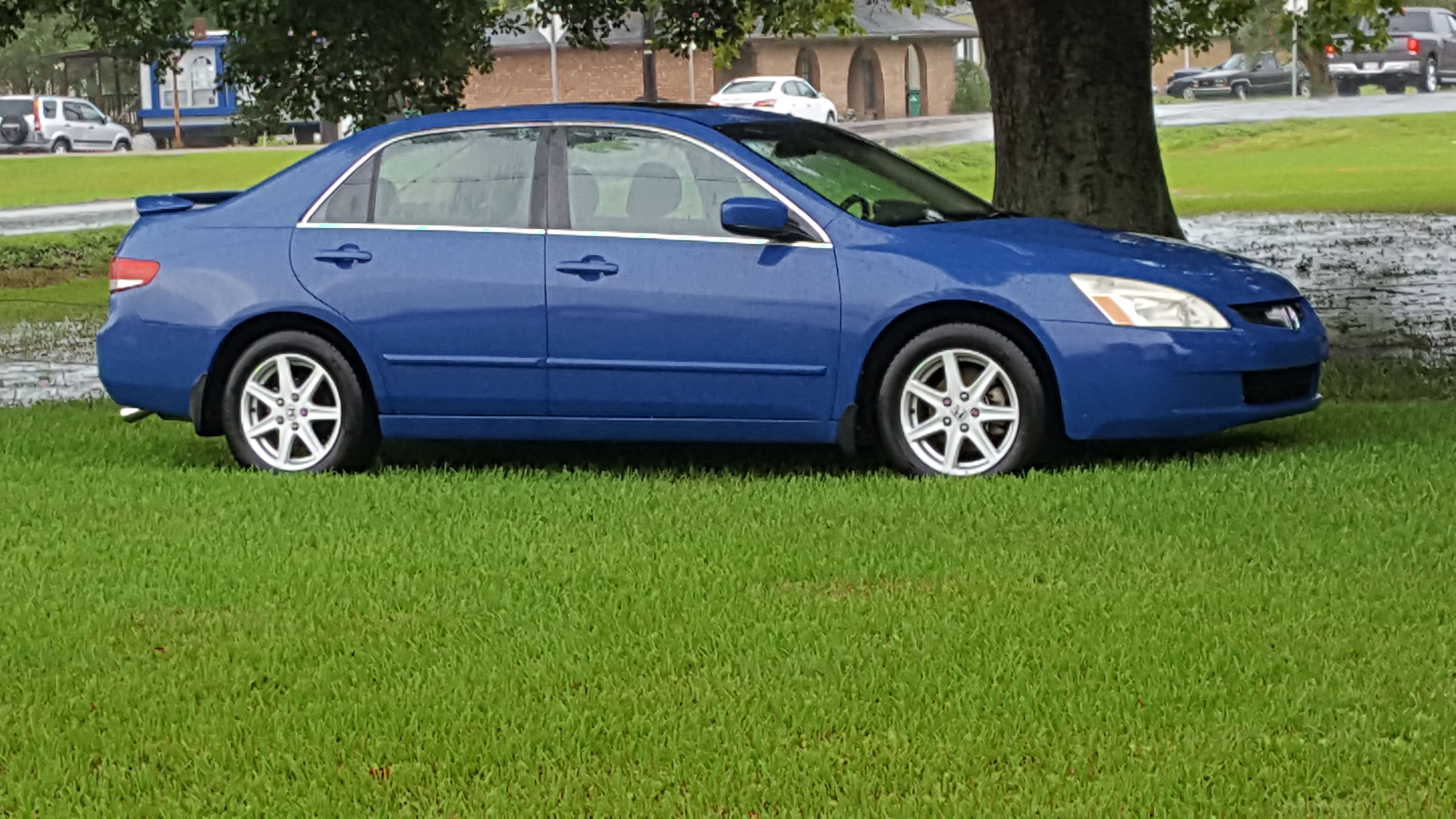

I painted my own car, and it came out fine, but it's a lot of work. Something I will never do again. The car went from Black, to Blue because the clear coat was peeling. I removed the door handles, door moldings, grill, rear view mirror thingies, rocker panels, and mud guards. Everything else was taped/covered.
Good luck.

Old Sep 28, 2017 | 07:06 PM
rockhoundrob's Avatar
Joined: May 2012
Posts: 427
Nice job! What did you do to sand it down? By hand or electric sander?
Old Sep 30, 2017 | 05:33 PM
EXV6NIGHTHAWK's Avatar
Joined: Mar 2007
Posts: 710
Air powered dual action sander. It makes it as easy as it can be, but still a lot of work. I painted the car in Acrylic Enamel, and no clear coat. It can't peel off, if it's not there.
