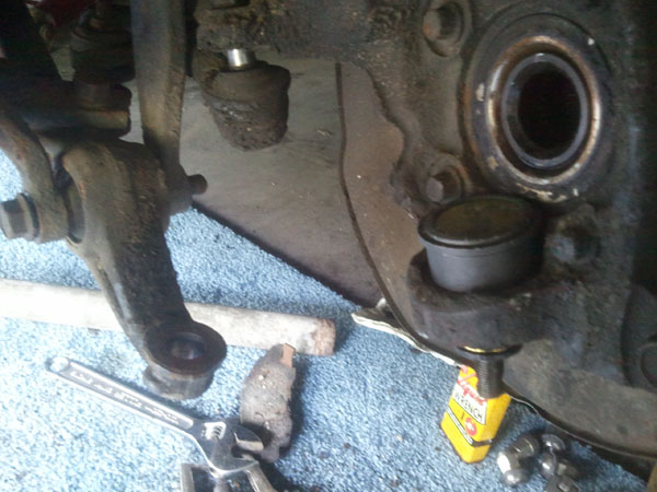

I got everything out. I used heat on the lower control arm, and banged the hell out of it (where the stud goes thru) - then smacked it from below until it popped out.
On the ball joint, I purposely cocked it a bit in the bore so that the flange of the ball joint where it was interfering was moved over as far as possible. Then I jammed a screwdriver between the ball joint and knuckle casting. I hit it from below with an air hammer - then removed the screwdriver - hit it again with the hammer and it popped right out.
As soon as I began to install the new ball joint I promptly discovered that my tool (one of those universal c-clamp style tools) was not going to cut it. I had read where you guys had talked about needing the "Honda tool". Now I get it.
I debated cutting up one or more of the adapters of my tool. Then thought about getting a piece of iron pipe and modifying it. This before it came to me to call O'Reillys. They have the correct tool as part of their rental program, so I plan on getting that - possibly tomorrow.

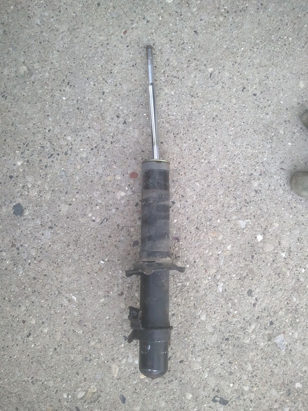

I then removed the struts and replaced them. Lo and behold, this is what the one from the left side looked like when it came out.
Finally a "smoking gun". But when I put the new struts in... same problem. The knuckle hits the strut - can't turn the wheel.
So I'm wondering at this point if the steering knuckle got bent? How often do these get bent does anybody know?
At this point I can't think of much else.
