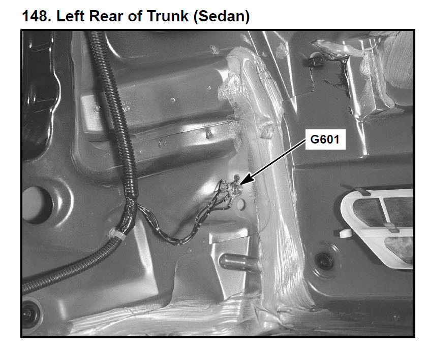

If your high mount brake light works, it wouldn't be due to the brake light switch.
Check the ground connection and wires at G601. You'll have to remove the interior trunk trim first (remove four plastic clips, then carefully pull up the trim piece).
This photo is for the sedan.

Did you check ground G601 and the wiring as I posted previously?

Thank you for your help in finding the G601 connection in the first place. My research has shown that it is a common culprit!

First, take a look at it. You're looking for anything obvious, such as corrosion on wiring and/or ground bolt, broken wire(s), loose ground bolt, etc.
We can move on to testing if you don't see anything obvious. If you have limited testing equipment, I can try to think other type of tests.
