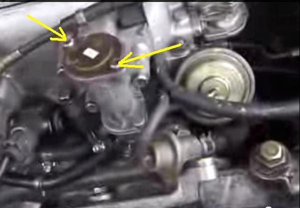

Ok, can you get the car up to op temp and remove the two screws marked in yellow in this pick and tell us is there is air being sucked thru.

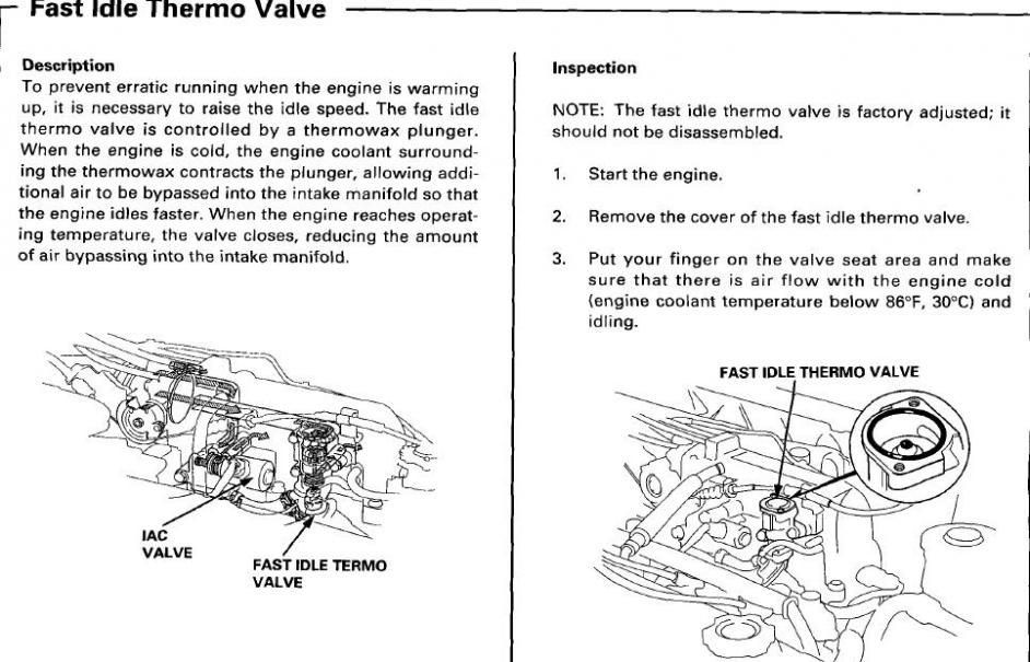

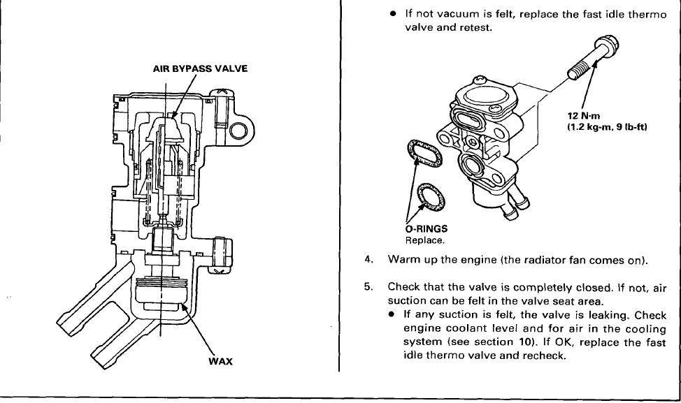

There is an issue with the FITV. At normal op engine temp you cover the lower port in the tb and idle drops. You open the top of the FITV and there is vac when the car is warm/normal op temp.
This is where I feel bad because I can't remember the FITV set up on the 4th gen's, been WAY too long. I "THINK" when that cover was off there is a "slit/slot" on the ball under it.....please confirm before going forward.
If so, remove the FITV from the TB. Gently roll/fold it back from the tb and give the ports that seal to the tb a bath in carb/tb cleaner....should be two ports...think about it, it is an air bypass of sorts.
If you really want to prove me wrong....while the valve is off the tb/intake....spray a good amount of carb/tb cleaner thru the lower port in the tb intake.....I bet it comes out the port/hole where the fitv mounts
Then re-install the fitv....either a new o-ring or a "light coat" of silicone on the old o-ring.. Then "snug" the ball down.....kind of a feel thing so I can't give more than that.
Either a new o-ring for the cover...or another thin coat of silicone and replace the cover.

Well again I'm hung up on the FITV because of the fact you cover the port and it goes down - with the "cap" off there is vac when the car is warm/op temp. Again, sorry but both of those things have me stuck on that.
The only other "reach" at this point is that the coolant isn't flowing thru the lines going to the FITV.....can you remove the two coolant lines and blow compressed air back thru the two hoses.....remove the rad cap so you are not fighting that.
Or if you have a temp reader.....verify the same temp on both hoses on the fitv.....still not a good test because if the "inside" is bad it will read the same.
Check for vac leaks around where the fitv seats/seals to the tb.....I'd use carb cleaner, so I guess that is out?
I've been wrong before and will be again...but to me the "signs" are pointing to the fitv.
