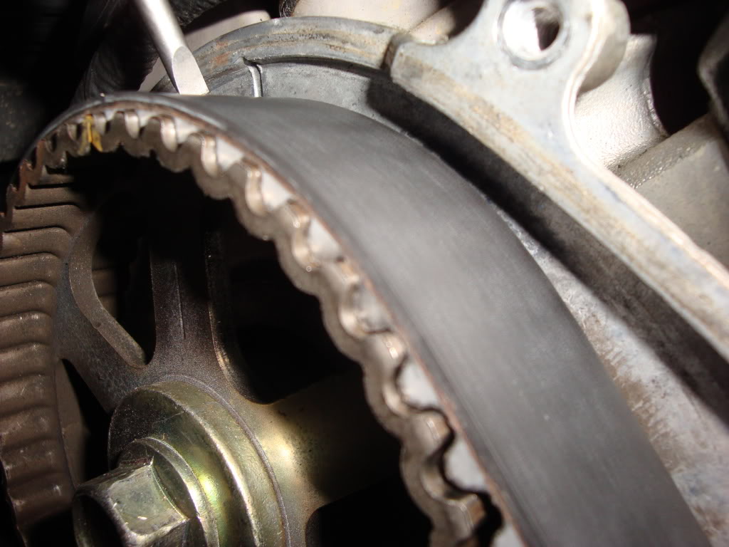

Well it looks like the cam shafts are aligned/timed with each other. On the front cam shaft the yellow dot is aligned with the dash on the block and a dash on the cog with a corresponding number 1. The yellow dot on the rear is also aligned with a dash on the block and a dash on the cog. See pictures.

Here are the pictures, I dont know why they did not work before.

Well I used the long screwdriver trick to find top dead center of #1 piston and verified my timing marks. The timing belt is installed correctly. And the knocking noise is unmistakably an internal engine noise.
