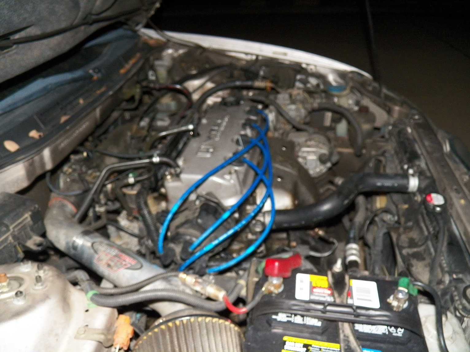

Here's picture of the before and after
before
after
Looks to be the same. Do you hear anything else in the video?
Old Aug 27, 2015 | 01:41 PM
Wire routing looks OK.

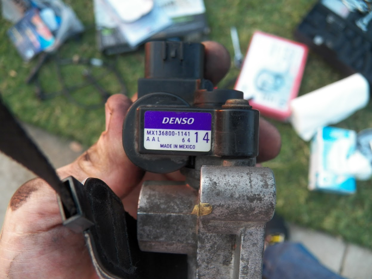

Tonight I cleaned out the IAC , it appeared to be stuck. Car appears to be running better but still won't start on its own and will only stay running with the gas pedal engaged. CEL light finally came on after a minute of running the car. Misfire in cylinder 4.
