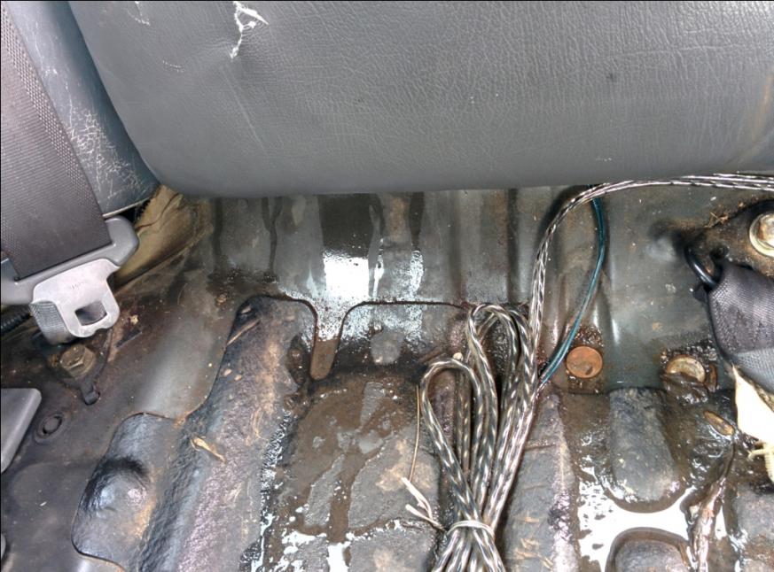

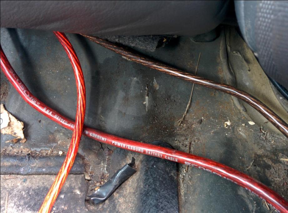

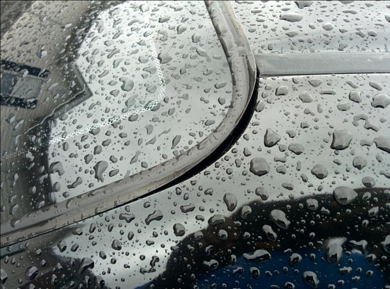

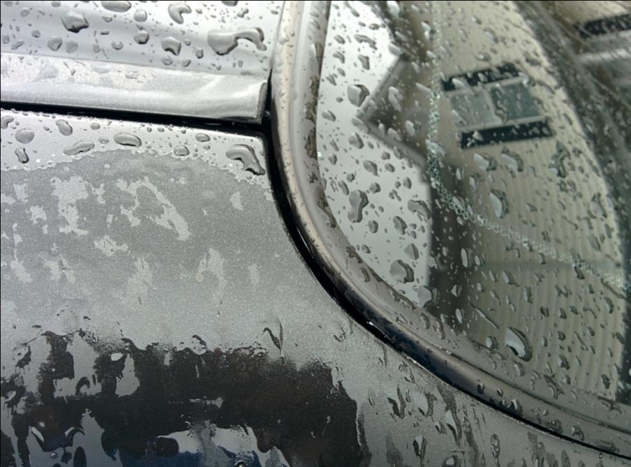

Anyone know where I can get the trim/weatherstrip that goes around the rear window? I have narrowed down my water leak to the weatherstrip that is on top of the window n the outside. It is leaking water into the cabin underneath the rear seat and the cushion is socking it up. I don't see any references to the trim on any Honda site.

It looks like #9 in that picture is the molding.

If you want a new seal then go to Bernardi Honda website, go to parts, enter your VIN and search under body/trim. Write down the PN and call your local dealer for availability/price. Otherwise, clean and dry old trim seal, apply some black RTV at the sealing surface, reinstall, let dry and see if problem goes away.
