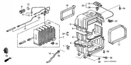

The water could be from the sunroof drain tube (since it rained) or the A/C evaporator drain tube (if you recently used the A/C). #14 in the diagram is the evaporator drain tube.
Attached Thumbnails Water on passenger side floor under glove box-c-cooling-unit-461691.jpg

No sunroof, I did just use the AC as it is hot and humid here in northern Ohio today... Question then is it appears to be the A/C evaporator drain tube... How would I clear that tube as it most likely is clogged if I am getting water on the floor...
Old Oct 5, 2013 | 02:11 PM
Find it coming out at the bottom of the firewall, maybe difficult to see with the steering rack in the way.
Fish a plastic wire (like from a weed trimmer??) up that tube & root around with it. Maybe squeeze the tube? Watch for a face-full of gunk to come out if you're underneath the car. Something like a coathanger risks tearing a hole in the side of that tube.

I've used a wet vac to clear the drain tube. This has less risk than a probe wire and should clear the tube.
Leaves/dirt can enter evap box and accumulate to block the drain. The debris may not clear w/ either probe or shop vac due to size/volume of the debris. In that case, you will need to remove AC charge, remove and clean evap box.
