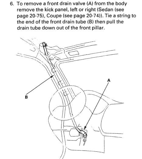

One possibility is the sunroof drain tube for that corner. It runs down the windshield pillar & out, so maybe the hose is moved out of it's proper position. I can't get the parts pictures right now, so can't be more specific.
Since it doesn't happen when you wash the car, but only when you drive, how about a leak through the floor? Only comes from water spraying up from the front wheel. Peel back the carpeting and/or have a good look from underneath the car.
Old Aug 22, 2012 | 09:09 PM
As Jim stated, could be the drain tube
Attached Thumbnails Wet Floor in Drivers Space-6th-gen-moonroof-drain-frt.jpg

Most of the time the tube/drain valve gets clogged and just needs cleaning - "A" in the picture.
Some will use a compressor and blow air into the tube to try to clear it. Some will feed something soft (like weed eater string) down the tube to try to clear it.
Not sure on the 6th gens - this works on the 3rds - sometimes you can remove the plastic inner wheel well liner and get to the valve where it "pokes" thru the sheet metal - then clean the valve from that side.
