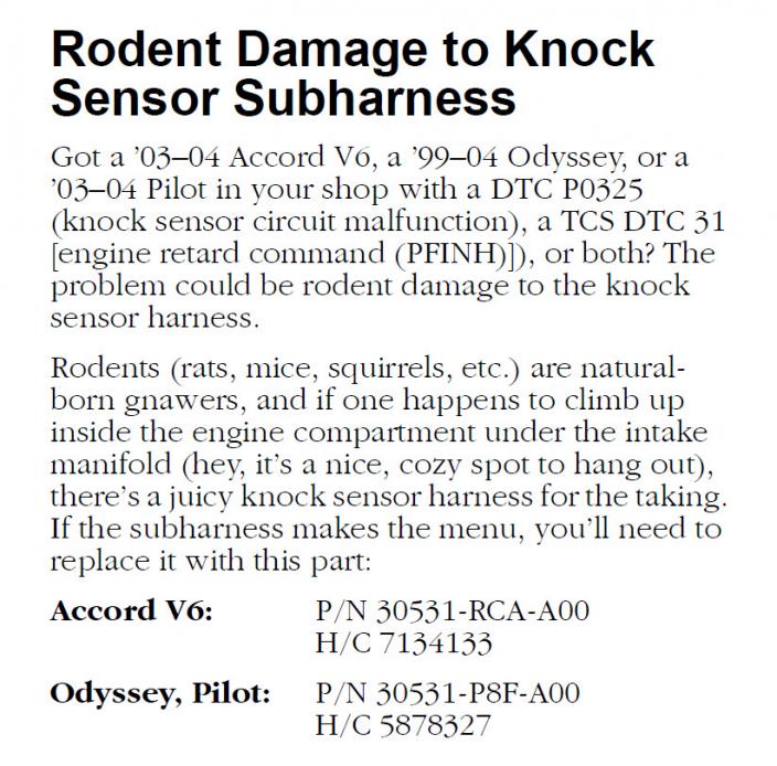

Old Oct 22, 2011 | 01:42 PM
Posts: 7,101
On 7th generation Accord V6, some Odyssey and Pilots, the rats like to crawl in the warm space where the knock sensor is. The attachment shows info. related to the Accord V6.
For your Accord L4, it may be some other wiring that the rats may possibly chewed on. So, I would start looking for chewed insulation.
Honda sells rodent resistant tape with pepper to cover wires after repair:
"http://www.bernardiparts.com/products/4019-2317.aspx"
Copy & paste without quotation marks to view.
