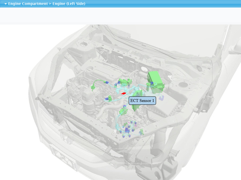

I had a typo in my initial post, it is ECT Sensor 1, not Sensor 2 (Sensor 2 is at the bottom of the radiator).
On a 4 cylinder, ECT sensor 1 should be on the driver's side.
The harness connector to ECT Sensor 1 has two wires (One is pink, the other Gray).
Attached Thumbnails Where is temp. sensor for the gauge on a 2013 2.4?-ect-sensor-1.jpg

After removing the two plastic shrouds, I see what looks to be a sensor on the cast water manifold
housing for all the water inlet/outlets, I'm assuming that's it.
Not going to be fun removing but that's the norm on these cars now!!
So I can go to Honda and ask for the ECT sensor 1 and they won't look at me like I'm a dolt??
Thanks, Joe
