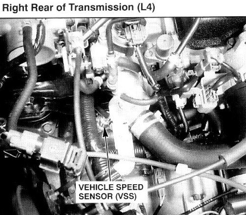

I though I'd check the Vehicle Speed Sensor, but I keep looking in the engine bay and can't locate it. Could someone post an image/diagram of exact location of it on this model... I thank you in advance.

The VSS is located on top of the transmission. At the distributor, look down to the transmission. It should be a little bit further back on the transmission, near the thermostat housing.

here ya go, but like redbull said, it needs a proper diagnosis.
