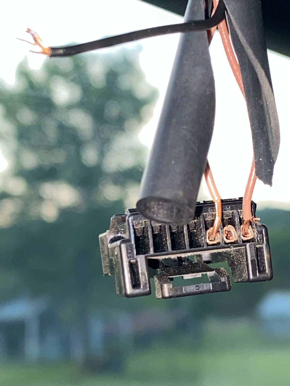

First, the wires to the plug for the windshield mirror need to be re-pinned/fixed. How/or what tools needed?

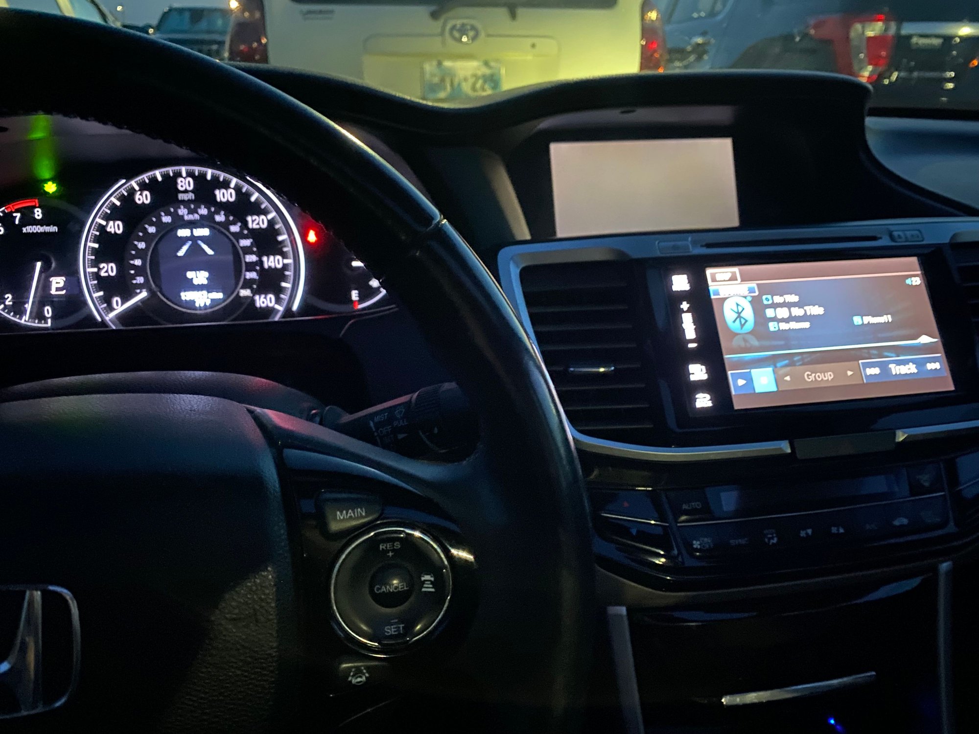

Second, the upper center display screen is blank. It is backlit so it has power, just no information on it. All fuses, interior/exterior, are good.
Windshield mirror wires are pulled out of plug
Upper center display screen is blank. Haven’t found any bad fuses.

For the mirror, you'll need a pin or needle to release the broken wire pin from the connector. If you are good with an xacto knife, you may be able to reuse the old pin. If not, you can try finding the whole connector with some of the wire harness, then solder the wires together appropriately.
