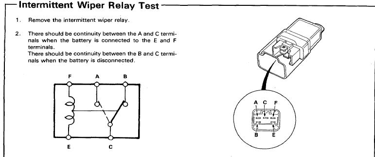

According to the manuals, check the Common DIY Threads for a link where to get one.
Test the switch and then the relay.
The relay is under the under hood fuse panel-pic has the testing procedure
Attached Thumbnails Wipers INT speed stopped working-4th-gen-int-wiper-relay.jpg

does anyone have instruction on how to check this or use the above provided diagram? I'm clueless as to what to do next...Thanks

Go back to the pic I posted (post#2). Test the relay. Is it good?
