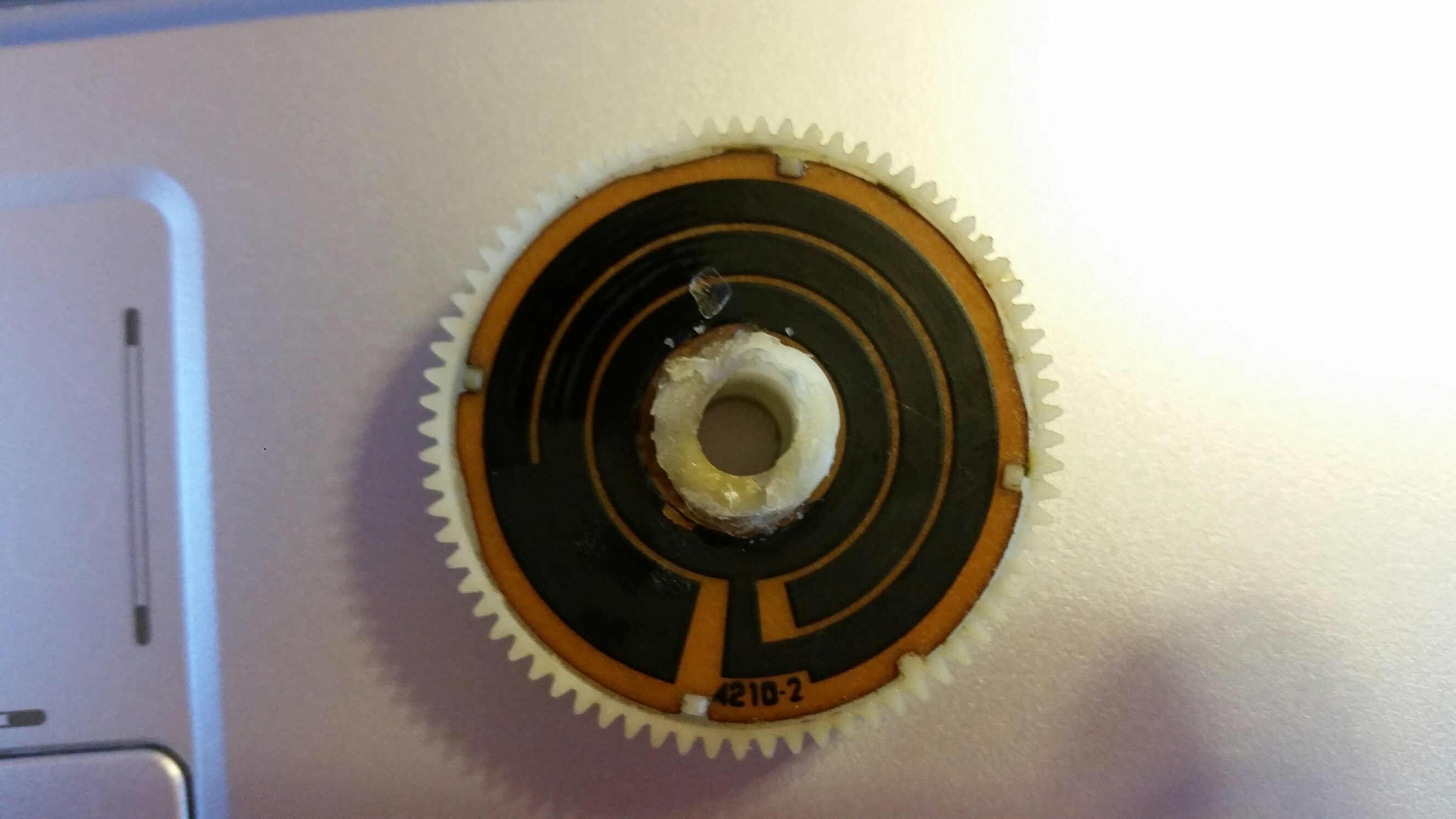

Default Air mix motor gear failed
Got it all together. Worked great until... the main gear in the air mix control motor assembly, the shaft crumbled. The plastic gear has a specific electrical circuit pattern on its face, so swapping out a gear from another motor will not work. The part number for the air mix motor is 063700-6780, but other numbers 12V, 11C, 0280 are on the cover. I do not know which of the two are relating to the gear.
Picture attached of gear.

Crazy glue did not work. Epoxied joint and filled hollow shaft with same. Hope it holds up.
