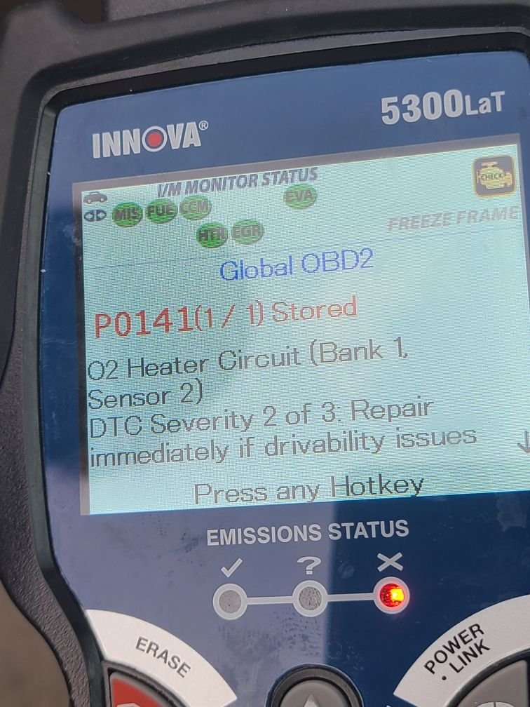

Old Mar 22, 2021 | 10:53 AM
AkaMrDre's Avatar
Joined: Mar 2021
Posts: 5
Default Codes
Old Mar 22, 2021 | 11:43 AM
Seanjordan20's Avatar
Joined: Jun 2017
Posts: 1,225
What brand O2 sensor did you use
