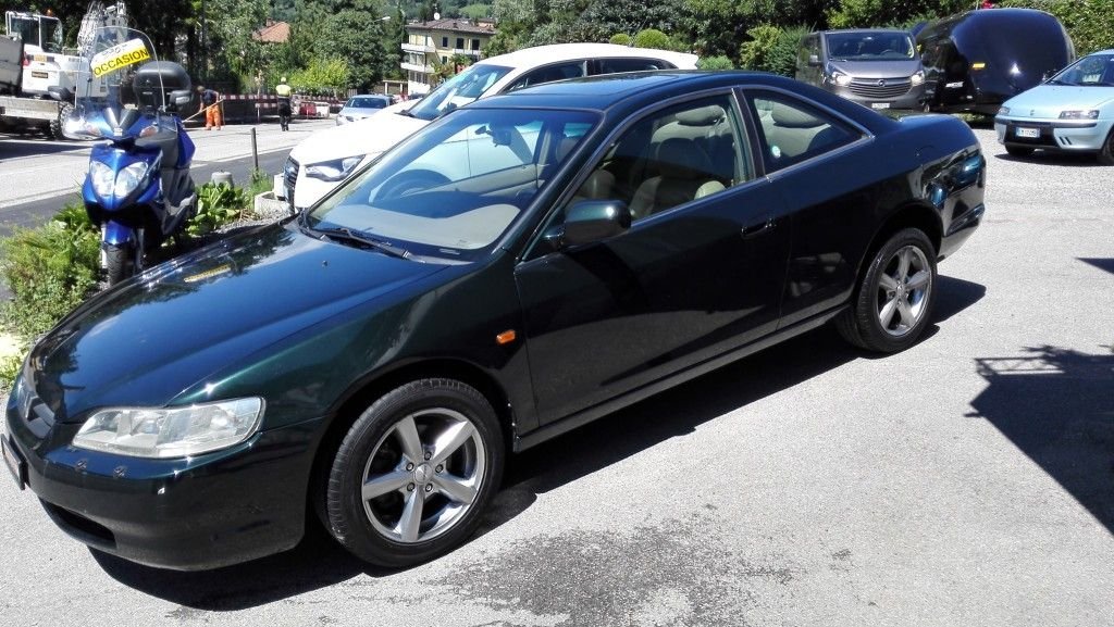

I bought a 1998 Accord Coupe V6 in 2017 (100,000 km, one owner) and it looked like a great deal.
Very impressed with the quality of the car (I also have a 1991 SAAB 900 SPG...) and it was really smooth to drive and enjoy. Didn't test the VTEC part yet since you will see that it's a long story.
