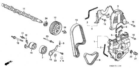

Check that bolt on the tensioner. There's a place for a bolt, but NOT SUPPOSED to be installed. Not sure right now, but I think it's at the large elongated hole on the left side of part #14 - balance-belt tensioner.
You put a bolt in there to hold the tensioner with some slack. When you re-assemble the engine, you remove it and ONLY use the outside nut, #21.
Not sure if it is the same bolt, will confirm it with my friend shortly.
So what happens if the bolt in question is left there Jim?
