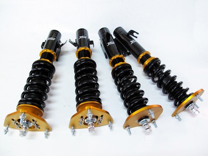

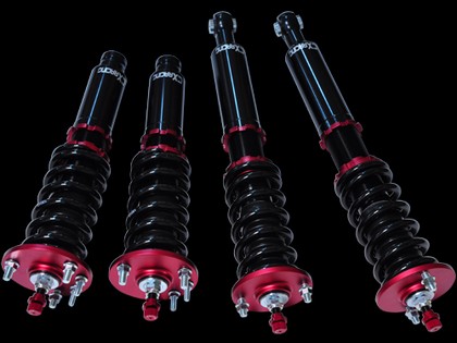

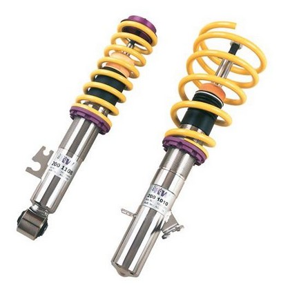

these are GC coilover sleeves. What they do is fairly self-explanatory, but I'll explain: they slide over the shock body in place of normal springs, but they can be lengthened or shortened to adjust ride height. Not quite as much adjustability or ride quality as a coilover that allows height adjustment from both ends of the shock body, but significantly cheaper.
These are Tokico D-Specs, which I've never personally ridden on but I hear great things about. They have adjustable damping settings, which is important so that you can match to the stiffness of the springs.
Those links are to Andy's Autosport, they have mad-large selection but orders take forEVER to ship, and their prices aren't just a little high with shipping. I've been waiting for probably a month at least to receive a strut bar, but to be fair it's a failure on the manufacturer's end...
EDIT: Then again, you could always just get coilovers.
Options go from the cheap stuff:
($727+shipping)
To the middle of the range (I have this soft spot for ISC, I'm really not sure why):
($955+shipping)
To high-end:
($1549+free shipping)
Attached Thumbnails Help me!! 06 accord lowering springs.-d-spec.jpg   Help me!! 06 accord lowering springs.-co-accord-cl-1208.jpg   Help me!! 06 accord lowering springs.-02-06-wrx.jpg   Help me!! 06 accord lowering springs.-variant1.jpg
