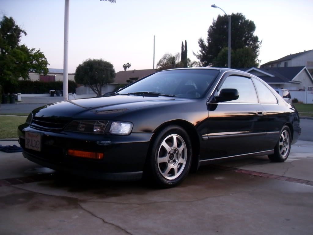

Here is a before picture on my Eibach springs.....
And here is now. The car is an inch lower than before.
