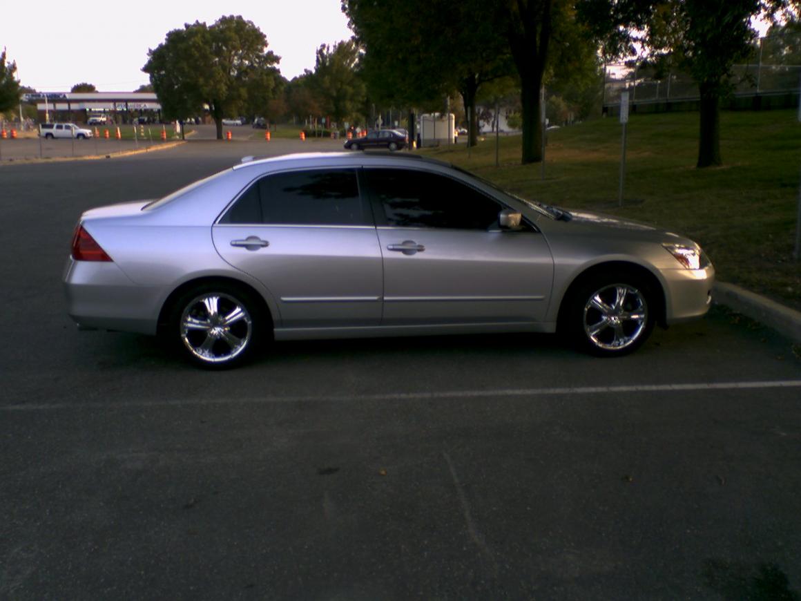

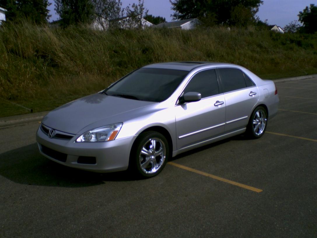

I just picked up a set of 17.7.5 Metal Fx M40 wheels with 225/45/17 tires. I'm not sure of the offset, but it must be aroung 40 as the rims stick out about an inch further than stock. This setup seems perfect for the accord. The set didn't come with hubcentric rings and after having the wheels and tires balanced twice I still have vibration issues. The shop that balanced them said they seemed to line up okay and aren't sure what the problem is. Trying to get info on which rings I would need hasn't been easy. I'll post pics of these rims on my car soon and let you know if a set of rings helps the vibration issues.
Old Sep 13, 2009 | 11:05 AM
gocubsgo
Default New wheels and tires on car!
Hi everyone, I just posted a couple pics of my upgraded wheels and tires. Check it out and let me know what you think. Any suggestions or comments?
Old Sep 13, 2009 | 11:09 AM
gocubsgo
Summer wheels and tires.
