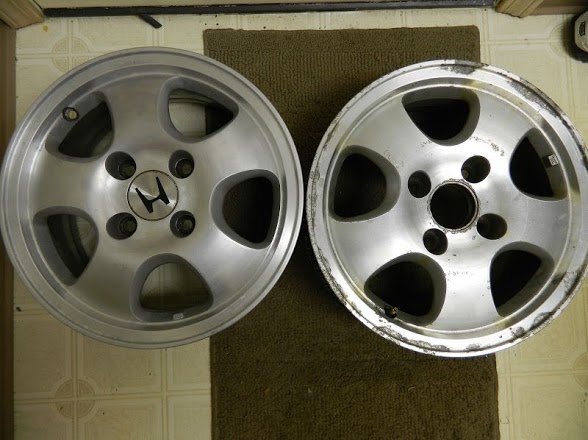

If you want to sand and buff, you CAN do it, I have about an average hour and a half into each one and I am almost done.
stage 3 polish, before
stage 2
Paint stripper from Home Depot,
Light sanding
then soft scrub on a 6" buffer,
then polish with a buffer with Mothers Mag and AL polish.
Attached Thumbnails Need recomendations for DIY Alloy wheel refurb-dscn0210.jpg
