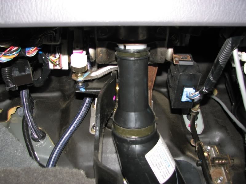

Pics of power wire through the firewall for a 2001 Accord Sedan
1/0 wire is blue in upper left, you can see another hole in the upper right with a single gray wire
I route the power wire up before coming down to ensure water doesn't want to wick in, while also building in some slack for future flexibility.
