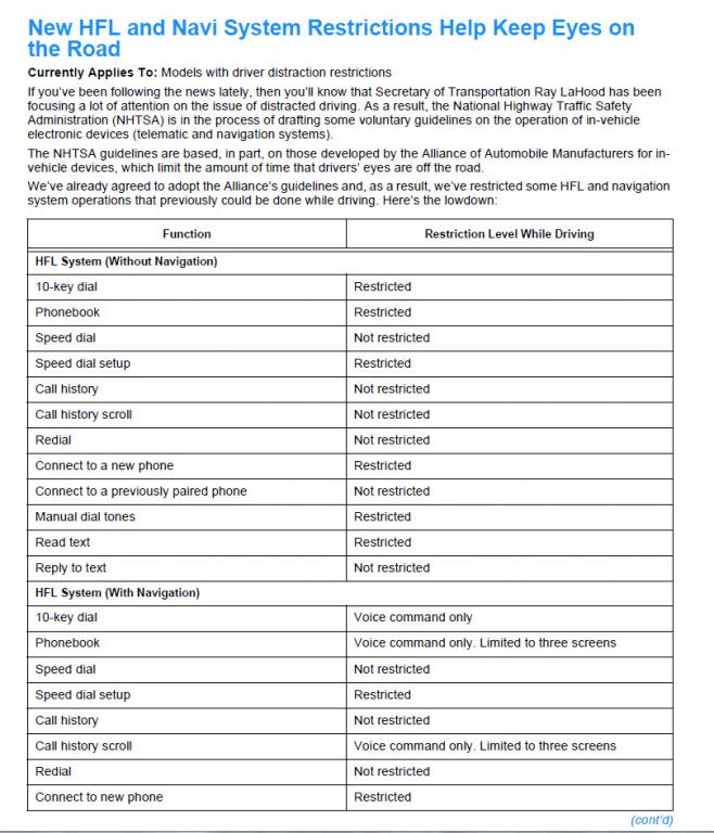

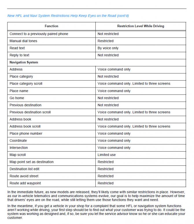

Just picked up my Accord this morning from the dealer. They replaced the "Navi/Radio Head/System Unit", including the hard drive. As posted earlier, I have had the intermittent blank screens at startup, slow computer response, hangup issues when using navigation with the vehicle moving, etc. So far, it looks like the updates resolved the slow response and navigation hang up issues. Time will tell on the intermittent blank screens at startup issue.
The system still disables functions with the vehicle moving (as designed), but the voice navigation seems to be more effective. I was forwarded documentation through the dealer that Honda is responding to future guidelines being developed by the NHTSA to minimize driver distraction, and all of their vehicles will go this route in future models. See partial paste below.

I am not sure if what you have includes this list of current Honda driver distraction restrictions for HFL and Navi systems.
Attached Thumbnails 2013 Accord problems with nav. and blutooth-hfl-navi-restrictions-page-1.jpg   2013 Accord problems with nav. and blutooth-hfl-navi-restrictions-page-2.jpg
